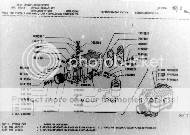

I've stripped cleaned fiddled etc with my reader and come up with these I think the negative looks worse than the adjusted 'as is' photo reckon with a tripod in the dark I could do some quite sharp pictures these were done hand held so a bit shaky
these were shot quite close up (as my spare engine is next to the reader can't get any further back!) I think that if I move the reader and set it all up in a darkened room at a longer focal length it will get rid of the dark centre spot of light when i can find time I'm going to give it a go at doing the whole S2FL2 fiche as it will be handy to have on the computer. the real beauty of the parts listings is of course that you can see how any part was meant to be assembled rather than the part numbers although they can still be useful occasionally

I've started this task images are nothing special but are clear enough to help with identifying parts and how things were originally assembled should take a few days to complete (only doing about an hour per day it's tedious!) then edit each frame

well I've done about 90 pages of the fiche so far, it takes ages!! Repro. is so so but adequate to see how things go together and in most cases the part numbers. I am just not methodical enough to get it all spot on straight and no bits chopped off but at least it will be something that can be quickly referred to instead of struggling with the fiche reader in the garage. Example final pages below although the originals on my computer are obviously a larger scale than this
