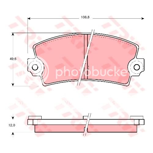

The rear pads are shared with some Renault Espace models.

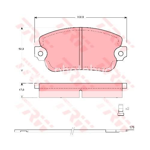

A number of fiat group cars used very simiar bendix calipers and looking at the catalogue there are a number of pds that should fit though they are not an exact match.
Beta pads are shown as 108x53x17mm. Fiat Strada TC pads for example are 108x49x15 but it's not clear whether the 4mm comes from the inner or outer edge of the pad. The only way to know for sure would be to trial fit a set.

Front
Rear
in my experience not all Beta compatible after market pads are exactly the same size some have a smaller contact area and are probably not exactly right for a Beta will fit but will obviously have reduced braking power and will result in horrid narrow rusty strips on your discs.
