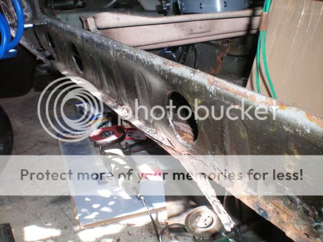

progress still slow other jobs taking priority such as gardening, repairing the cars that usually do work when they are not etc..... the offside sill is cut off inner sill is not too bad aside from bottom edge and both extremities, the horizontal section that meets the floor is a mess of rough rusty repairs and also needs chopping out. This side is a lot worse than the nearside which in my experience is typical of Lancias. I have separated the spare engine from its subframe and gearbox whilst the engine in the car was (is??) OK i might opt for the spare as it has had a refurbed head, bottom end bearings and so on fitted not long before the car was scrapped so may be a better bet although I don't know the quality of the work. Subframe appears better than the one in the car at least in that the dents are not so big!! Anyone ever seen a beta subframe that doesn't have dents?? So maybe I will build up the spare engine and subframe and then swap them over. As usual thanks to Steve Thompson for help with welding, mechanical bits and his encyclopaedic knowledge of Beta repair technique trivia.

Steve is doing a truly magnificent job with the offside sill and floor, it is 2000% worse than the other side and has needed some rather involved and complex repairs

sill blasted and painted ready to go on! looks quite posh the panel will be cut down to fit we are not ambitious enough to fit the whole piece!
