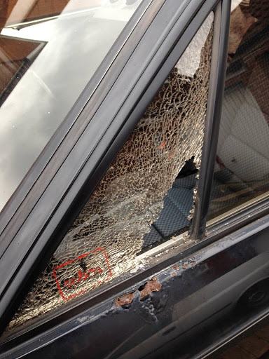

« Reply #29 on: February 23, 2016, 03:06:21 PM »
Well, as a little update, 10 months ago John Brain had time to take the Volumex off me to fit droptop's replacement cam housing, timing belt, gaskets etc for me. It came back to me 8 months later (!) (to be fair to John, he'd had an unexpectedly large amount of work turn up) and it is ticking over like an absolute beauty. Like a sewing machine  Cheesy
Shortly after getting it back I spent a fair amount of time trying to find out why the new carello housings and lamp units I'd fitted where popping fuses every 5 minutes. Failed, ripped all the wiring out and started again:
All working beautifully.
I'd had the rear gear linkage bushes fail on me just before John picked it up (front had been replaced by previous owner):
I also now have a functional cigarette lighter, rear fogs and cooling fan override.
So the next job it to replace both rear bushes this Friday, parts from Mark W.
I also appear to have a pinhole in my manifold, right where the downpipes fit into a bracket. So I'm going to putty that up for now.
Then, as a little birthday present to myself I bust the left quarterlight (passenger side in a RHD car) pushing past the mirror trying to get at something in the garage this morning  Angry
So if anyone can help, please do!:

« Reply #30 on: February 24, 2016, 07:55:10 PM »
I have just this afternoon managed to source not one, but a pair of bronze tint VX quarterlights in nearby Chippenham! So I'm all set and not in need any longer as I've just got back from collection.
I thought I was going to spend years trying to trace a bronze tint replacement!
I also managed to pick up clear beta windscreen, tinted rear heated screen, Brian Long's Collectors Guide and the much vaunted Guy Croft Twin Cam book. So I've been spending my money, but I'm rather pleased with my afternoon's haul  Grin

« Reply #31 on: February 26, 2016, 09:15:57 PM »
Before:
After:
The eagle-eyed amongst you might just be able to spot a small bubble of rust ... I have some new doors and a few other bits in the roof of the garage to fit at some point.
Mirror was refitted shortly afterwards. Getting the new quarterlight in was like bleeding krypton factor! Ended up dismantling most of the door.
