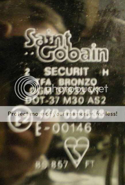

sounds like it's probably built after the 01/1984 revision shown on the microfiche assuming it's original does your glass have a '4' date code by any chance?(??)
Which number is the date code? I was hoping it would look obvious to me, but it doesn't... Huh?
usually a single number with a few dots on either left or right of it

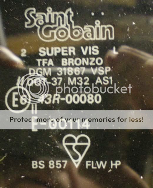

« Reply #24 on: April 11, 2011, 05:28:59 PM »
Nothing like that...
Saint Gobain
3 SUPER VIS * C E
DGM 36828 VSP
DOT-37 M25 AS1
BS 857
FLWHP B
43R-00080
E-00114
What I have just noticed is the front screen is Saint Gobain but all the other glass is Sicursiv climaglass... is that normal?
Anyway, the current state of play is I'm having one made via oldschoolwindscreens.co.uk with the correct bronze tint but unfortunately no top tint  Angry Sad which is a shame as it seemed to be quite unique...
Andrew.

« Reply #25 on: April 11, 2011, 10:54:53 PM »
vx coupé
windscreen
and side glass
I believe the 2 indicates manufacturing year (1982) although I think that makes the glass quite a bit older than the first VX Coupé yours seems to indicate 1983 (Huh?) AS1 indicates 75% minimum light transmission (legal requirement for windscreen) and AS2 70% minimum light transmission (legal requirement for front side window) the rest I don't know
